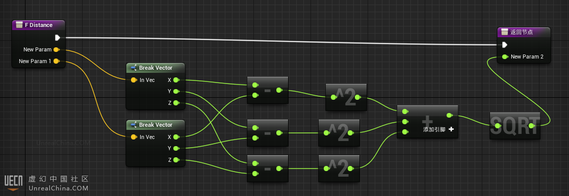

我在名为distance的蓝图中写如下的函数(计算两点空间距离)

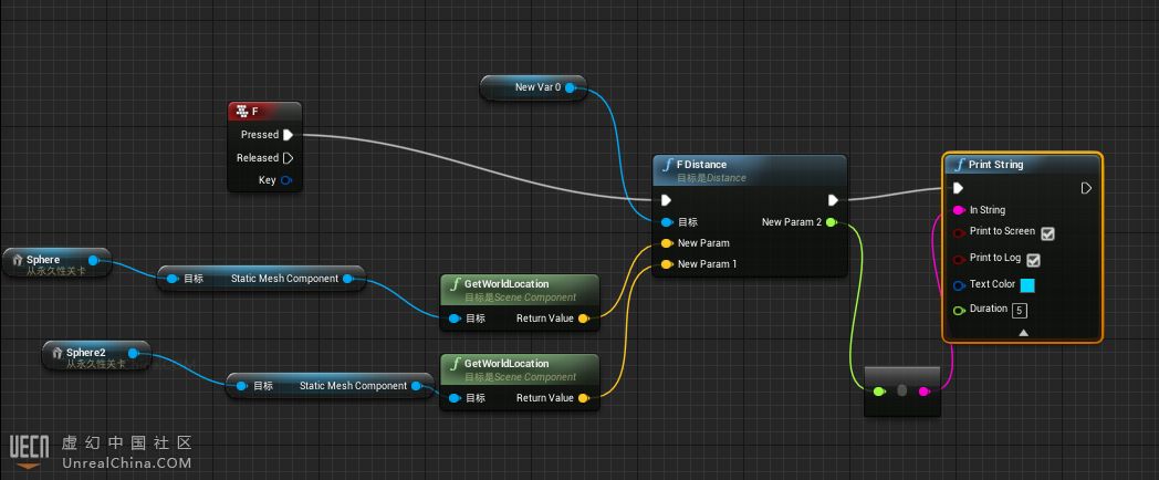

在关卡蓝图中写了如下内容,其中引用了distance中的函数

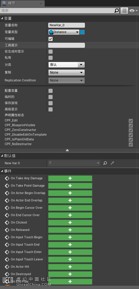

New Var 0 就是引用的蓝图,左边眼睛点亮了
但是报错:
错误 Blueprint Runtime Error: Accessed None trying to read property NewVar_0 from function: 'ExecuteUbergraph_Minimal_Default' from node: F Distance in graph: EventGraph in object: Minimal_Default with description: Accessed None trying to read property NewVar_0
而且输出的数值是0

new var0没有赋值
spphins | 2016-12-26 20:47:01 | 显示全部楼层

怎么赋值,在level中创建一个distance蓝图的实例吗?
40412440 | 2016-12-26 21:21:47 | 显示全部楼层
distance蓝图  把这个蓝图拖进场景中即可!
补充: 拖进场景中,选择这个蓝图.在关卡蓝图中右键.即可引用它

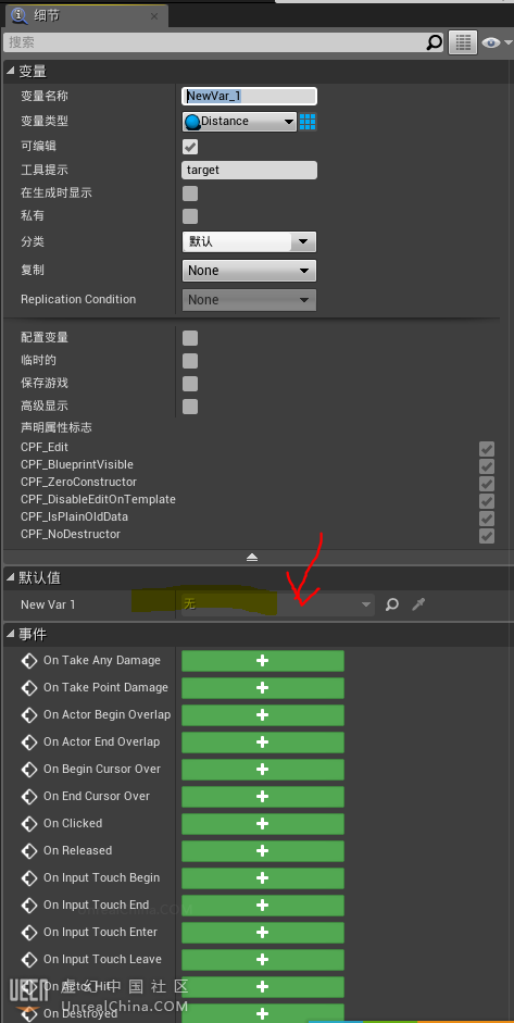

拖入场景中在引用的方法我成功了。但是添加变量的方法还是没有成功(即使我把distance拖入到了level中)
更新:
我看了官方文档 Direct Blueprint Communication is the most common method of Blueprint Communication and is great for when you have two Blueprints that you know you want to have talk to each other at some point. This type of communication is always one-to-one; meaning one Blueprint (the "Working Blueprint") is requesting to access another Blueprint (the "Target Blueprint"). The simplest way to use Direct Blueprint Communication is to get a reference to the Target Blueprint through a publicly exposed object Variable and then specify which instance of that Blueprint you want to access.
红字说要要有一个实例。。。但这个不能赋值

1.在level蓝图中创建一个distance,然后赋值给new  var_0变量
2.拖distance到场景中,在level蓝图中引用它
